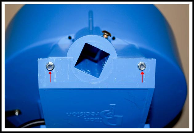

Using a 1/4" nut driver or socket loosen the two screws on the bottom of your casefeeder just enough to allow the base bracket to slide in.

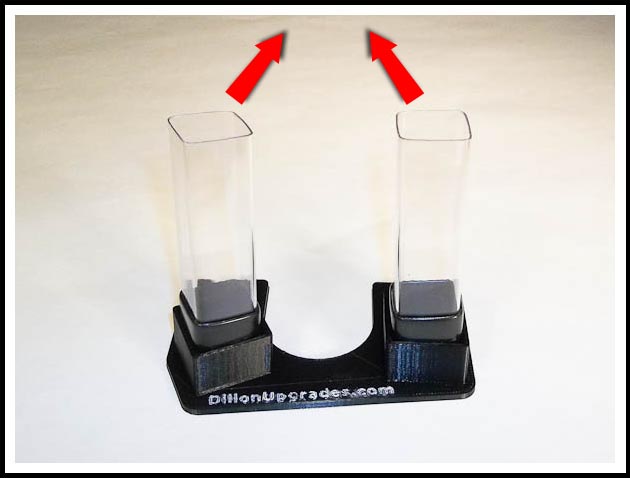

Next losely inserting the riser stacks into the base. The riser stacks should be angled back toward the feeder in the direction of the arrows. (older version show)
Now just slide the assembly in until it stops and retighten the screws. Adjust the riser stacks so that they line up with the dump holes in the bottom of the bowl. You can lift the stacks up a bit to come in contact with the bottom of the bowl to better insure the debris will fall directly into the stacks. Periodically check the stack before/after loading to see if they need to be emptied.
